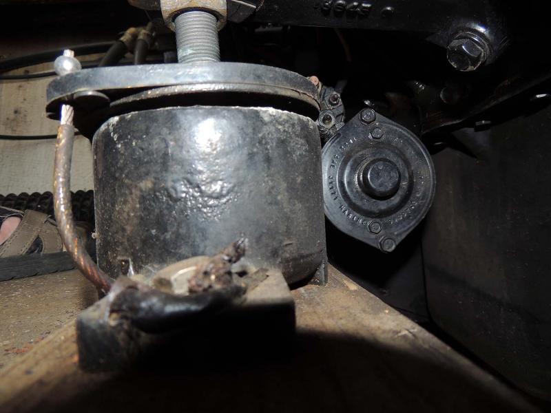

I have a starter that is not working. What part number or where can I order one from? It is a 4.2. 1986 futurecraft boat. any help would be greatly appreciated. Also how hard of an installation is this? DSCN4436.jpgDSCN4437.jpgDSCN4438.jpgDSCN4442.jpg
remove the battery cable from the battery, remove the wires, remove the 2 bolts
Did you verify the starter actually being bad?
Did you jump the yellow/red to the battery lug?
Are the battery cables AND the cable ends clean and tight?
