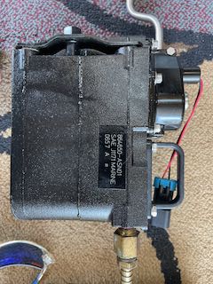

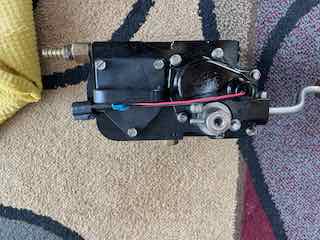

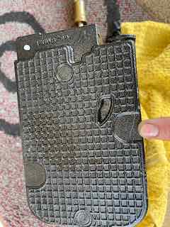

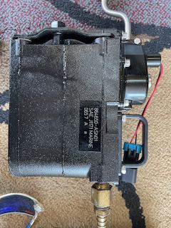

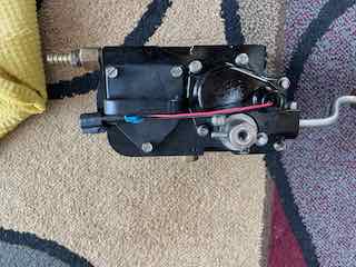

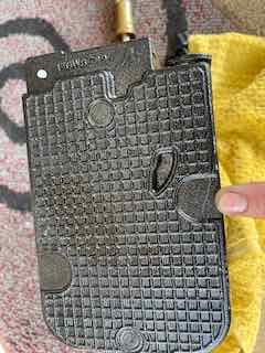

Hi. Started the motor for the first time this season, all good except I noticed water coming out of the bottom of the fuel module. After using my fingers to try and detect where the water was coming from and using a mirror and my phone for pictures, I determined the leak was coming from the housing. Did my research and removed the entire unit. Yup! found a crack in the bottom of the housing. My boat is a 2007 Crownline with a Mercruiser 350 Mag MPI 5.7L. Engine serial number "1A041321". Can some one help me identify the correct replacement module for the unit?

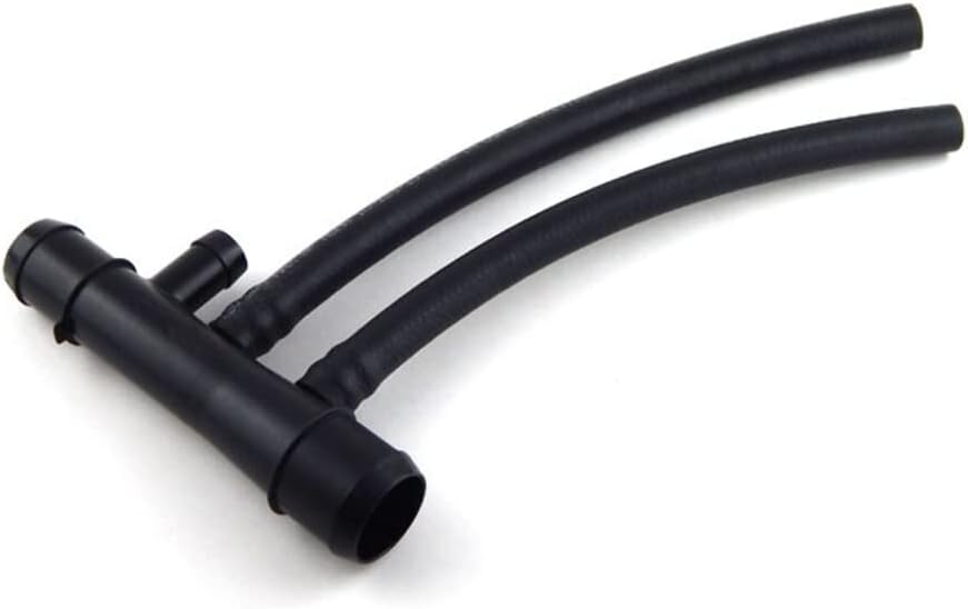

per the service bulletin you need
Replacement kits Complete Gen III module with pumps and filter 8M0047215

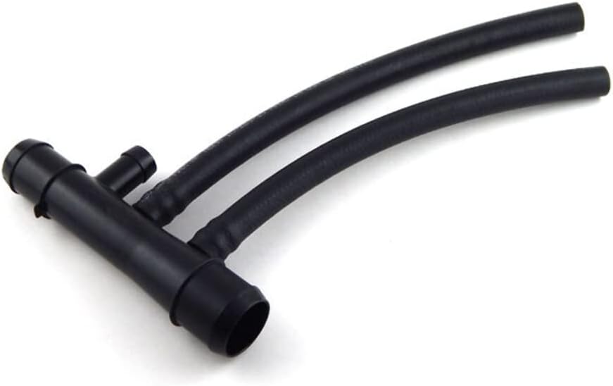

if you have 3 hoses coming from the supply hose coming out of the supply hose, you also need
Three bib hose kit 865208T02
good news is that the new pump kit has a drain plug that is actually accesible,
you can also get just the housing and transfer the parts inside . that kit is
Lower Gen III module housing (no pumps or filter) 8M0047216
