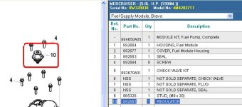

Hi have you got any closer to solving the problem? I have a similar problem with a 2005 5.0L MP1 Brovo3 with 78hrs Serial No: 0W328030 Model No: 4M42037TT which came with the Rinker 232 Captivia as new. It was serviced at end of year, kept on a trailer. Unfortunately we have only had the weather to take it out twice this year in the last two months, all new fuel. It is a lumpy tick over and would stall when going from reverse to forward coming off the trailer and then seemed to take longer to get out of the hole and then going to Cowes week lost power. The Mercruiser main dealer mechanic is having problems sorting, its ticking over at 525-560 rev he says should be at 600 he thought it was the IAC valve as he didn't think it was controlling the airflow correctly to increase the revs but it didn't make a difference but it was chucking carbon out in the exhaust water. looking at plugs found they were black with carbon and didn't correspond to what should be in there. Carbonised plug etc indicates running rich which is either too much fuel or not enough air. He checked the rotor and cleaned it up fitted new plugs and leads checked with a timing light on each lead that there was a signal. Tried again still same new plugs covered with carbon, then he checked the fuel pressure found it went up to 90psi (which he had never seen before) he said should be around 32-38psi took the regulator of at the cooler 3 and found a ring of paint had come off the housing and was stuck across the regulator he removed that and it performed better the revs came up but the pressure was still gradually building up to around 50-55psi so he thinks the regulator part below is faulty. Typical best two weekends of the year and engine is playing up. I am waiting to see if he can get the part separately i see you can get it separately in US for around $90 so they should be able to get it over here.

The regulator needs to be changed. Sometimes you can clean them and sometimes you can't. If has never seen the pressure that high, it's time to find a more experienced mechanic.

Guys thanks for the info, now I have to decide which regulator to change the one on the cooler 3 or the one on the fuel rail, as they are both joined by a rubber tube, then to find where i can get them from easily in the uk. In USA seems to be so much easier to locate and obtain.

The Mercruiser main dealer mechanic is having problems sorting, its ticking over at 525-560 rev he says should be at 600 then he checked the fuel pressure found it went up to 90psi (which he had never seen before) he said should be around 32-38psi.
The regulator on the fuel rail is a dummy and does nothing on marine engines.
