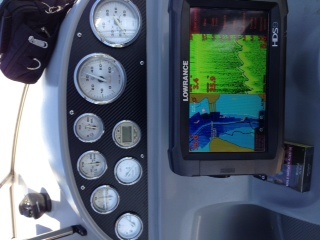

Ok, here's the latest update.
Replaced the Dissy Cap & Rotor, swapped Ignition Control module with my mates one, took the boat out to the river today & guess what, THE Problem is still there.
Bellow is a snap shot of the instrument cluster and GPS showing the speed when the problem occurs.
Also hooked up an external digital tachometer up to verify the boat one is reading correctly.

As you can see in the Instrument picture above everything is running a normal Temps & Pressures
I'm at a lose with this issue
