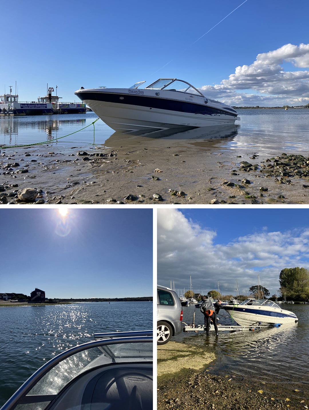

We managed to fit in a trip to the coast (Christchurch, Dorset, UK) for a full water test this week, which went great and we got very lucky with the weather too. All apart from a being a bit choppy out at sea (so only managed to get some harbour photos). The carb needed a little further adjustment as was expected (when underway), but she ran great 🙏...
