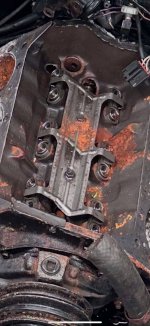

Hi Thanks for you answer again the heads I have are 14094768(non vortec) they fit good on the block so far with all bolts aligned.
The intake manifold does not sit properly because of the balance shaft in the way.
The bulge is hitting on the balance shaft I’ve searched everywhere can find any answers.

what is behind the heat shield that is riveted on. I would try to knock rivets out. usually that is only there to keep hot oil off the bottom of the intake.

@kghost thanks for the input , the issue I'm facing here my heads are non vortec (but the replacment block is from vortec engine)therefore I need 12 bolt intake not 8.
@Dieter so removing the shield will solve my problem?, will there be consequences?

I would hope removing rivits and steel pan will work. Balance shaft appears to deflect oil. I have no personal experience with this swap.

I would think you can take off the shield (should be done for cleaning anyways), and maybe some more hot oil gets on the intake and it is warmer?
I doubt you would be the first one to take off the shield and not put it back on over the last 50 years...

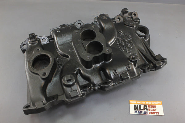

This may be the intake you need but I cant confirm 100%. It says vortec but it does not have 8 vertical bolt holes but the heat shield is flatter may be what you need
https://www.ebay.com/itm/316615520852?_skw=marine+4.3+intake+manifold&itmmeta=01JSCT77SNTJ0A2RXHYDWV659D&hash=item49b7c17254:g:X6QAAOSw1uVn0uAU&itmprp=enc:AQAKAAAA4FkggFvd1GGDu0w3yXCmi1emOOiTUx0DmxdvA9efeWD7NMplmhXmXWFCxc74wxgRcQEjGUK+4tOSnjp2HWQR4g93Xa9K2xll0w9NEoy+jBVT3KhTeWySzc33Pq93tWpF0V6QZowK7u3RdXDa23eY22jpDTbPyQ1kgFAYiwFc2WWAXHt8WiiDMR5NsmspwmYoKoUdfqa7eUCvr9ajrYay8r7ch2+vCUlQvnQ0g4xW9zzgeArIa+/VpDHd9+7SwEa/67pE6WOrkPHIgj42NdViCjaLJ/Jbk+M1gAttYJVEURdy|tkp:Bk9SR4D9nJrLZQ
when ever you get into mixing and matching a certain amount of SWAG is involved. If it were mine I'd knock of the rivets, clean out the crud , see if it bolts up, if it does use it
here is another listing for intake with flatter shield see note about for balance shaft 10 bolt metal timing cover
looks like part numbers are 824324T and 824330T for 2 and 4 bbl intakes respectively. booth are listed without the T then superseded to same P/N wit the T ...
