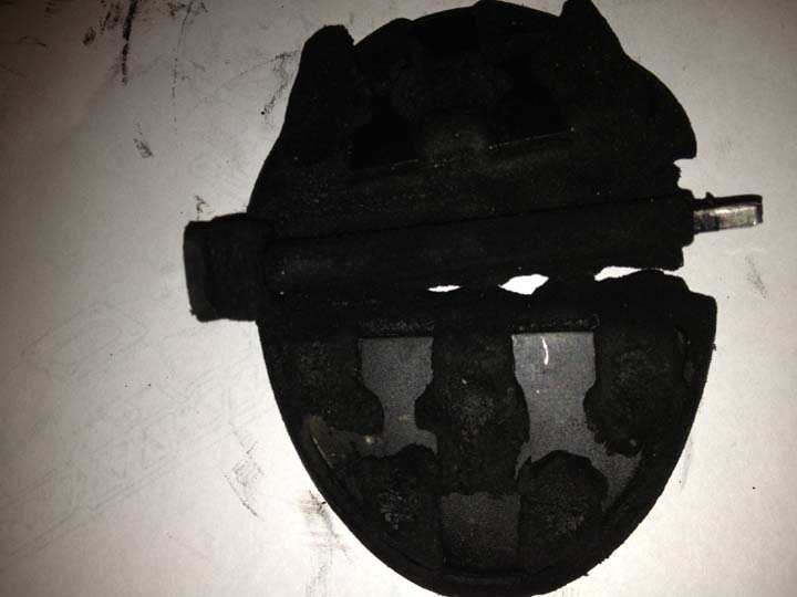

This is the flapper I removed. Was still in place but not in to good of shape. How important is this can I remove it completely or do I need a new one

Replace it or you stand a good chance of a backwash induced engine lockup because the cylinders ingested lake/sea water.
That question has been discussed I have a 85' no shutter.
What I do when I come off plane I do it very slowly and turn slightly.
It is up to you.
How does the elbow look?
volvo does not install flappers and recommend if they are installed to remove them.
