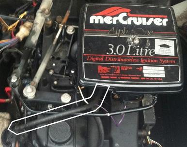

My question is concerning a line about 20" long with an approximatly 1/2" OD that comes off the top of the throttle body just under the air filter (see picture below). It's connected to the carb but the other end is currently just draped over the top of the engine and hangs about as far as the bottom of the block. In the loose end is a short piece of metal tubing that extends about 1/4" beyond the end of the line. Where is this loose end supposed to connect?

Here's a picture of the top of the engine with the line outlined (click to enlarge):

Ayuh,.... I agree with Guy, that's probably the fuel pump vent line,....
Don't use startin' fluid on yer motor,...
That's the P/O tellin' ya he botched the carb rebuild, 'n you've Still got serious Carb issues...
Thanks for the quick replies. That line isn't long enough to reach the fuel pump so I'll get a length that will and hook it up.

Went to an auto parts store and purchased a new 36" line Friday and got it all hooked up. Took the boat out for our first shake down on Lake Blackshear Saturday morning. Everything went great. Thanks again for the assistance.
