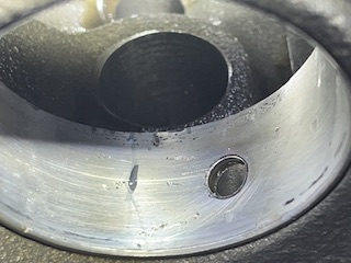

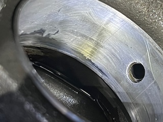

Recently purchased a 1981 StarCraft with a 2.5 120 hp Mercruiser. The motor had a good knock to it so ended up tearing it down. Cam bearings are exceptionally wore but also noticed the cam “rocking” back and forth. The cylinders all checked out at 160-165 psi. No visible signs of crank or rod bearing wear. Just the cam bearings. Lifters and pushrods all look good visibly, but maybe some minor wear on bottom of lifters. My current plan is to replaced the cam bearings, cam, lifters and pushrods just to rule anything out. Also while I’be got the motor tore down, was going to replace crank and rod bearings as well. Does anyone have any thoughts on what may be going on?

Yes that was my initial thought before pulling the cam, perhaps the thrust washer wasn’t installed. But upon pulling it out, I can see the washer behind the thrust plate. There is a core plug that I’m assuming the cam end sits against, it seems to me is properly placed. Something is haywire and at the most extreme I’m thinking bent cam? I’d love to save the cam if possible, I see some wear on lobes but nothing I would think detrimental. Was going to take the block and cam to the machine shop and spec the cam, and install new cam bearings.

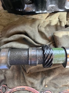

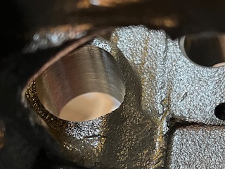

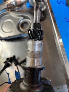

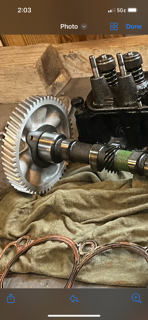

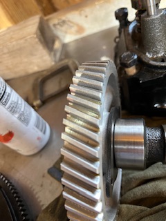

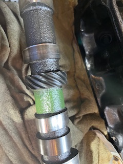

I finished up with work for the day and looked over the distributor shaft. I do see some wear and tear along the shaft and looks the same at the area the shaft drops in through the block. Is this because of the bad bushing the lower part of the shaft fits through? I can get a slight rocking dropping the distributor into the slot. I see the bushing is replaceable. Is the wear on the block a concern? Would this alone cause enough play to allow the cam to shift? Also some photos of the cam lobes, and cam gear.

The outside diameter doesnt move once timing is set so any wear should not impact anything.
If the wear on the bushing that is worn doesnt seem to impact point set up then you may be OK.
There are two bushings, one under point plate and one near gear side inside housing. Oil light type bushings.
If the one under point plate is worn the shaft will move side to side making setting point gap/dwell difficult.
I have seen them so worn the points once set would close when on the rong side of the wobble and cause bad running conditions as the dwell was all over the place thus timing was also.
Ok, I’ll take a peek beneath the cap. I feel it’s likely the cam bearings being the way they are is where my knock has came from, but trying to figure out where and why they went bad. As one mentioned, looks like they may have been improperly installed. Hoping I have caught this early on because otherwise the motor seems to be pretty good overall condition besides the current issie
I will be dropping the block, cam, and crank off at the machine shop Tuesday. I have the cam bearings delivered and going to have them pressed in. Also, for sure the engine block distributor bushing has some pretty good wear to it. I’m going to have them check the crank and rod journals to be sure they are not out of round. Also going to have them remove the cam timing gear and inspect the thrust plate and washer. The current plan if all checks out is to replace the cam with new if bad, new lifters and pushrods, crank and rod bearings while I’m in it.
