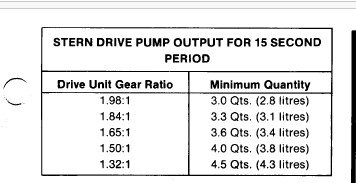

There are some tests you can perform. Not saying its easy based on running two engines but here are tests for Incoming water flow from drive.
You will need a single hose and attach at the thru transom fitting (incoming water supply from outdrive) This is the inside of boat, of the water hose we hve been speaking of that may be kinked on the outside at outer transom.
Merc has a flow spec based on gear ratio and I have copied it from 1985-1988 service manual.
I would recommend a CLEAR vinyl hose to do two tests at once.
Test has to be done in the water (clean water)
These two tests will either show an issue or end discussion of incoming water flow issues meaning No issues or Yes issues.
test 1. Bubbles in water supply test. Clear hose connected directly to the input location at on engine water pump. With a clear hose you can see if there are bubbles in the incoming water supply. a few are normal but a lot is not normal.
test 2. Flow rate. At 1000 rpm.
Below is a chart in the service manual. The flow rate is based on gear ratio.
Great info, thanks!!!! When I flushed that feed I didn’t see a leak after I thought about it so I guess a ripped hose is low on the possibilities. I don’t know if I will have much time to spend on it this weekend as some other things have come up. I will post here again with what I find. Leaving posts like this dead without an answer doesn’t help others so I will keep posting what I do, find and what the fix is. Thanks for all the help!!
