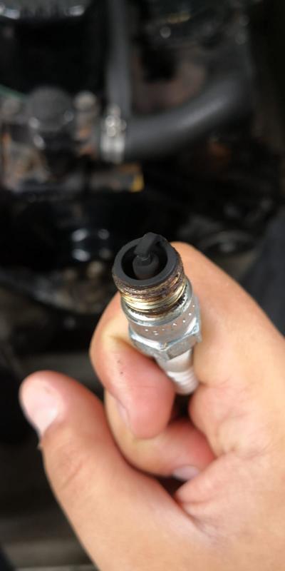

Next thing I did was checking and replacing the spark plugs and thats where things got weird because all 4 spark plugs were pitch black
They don't look oily so I guess it's just carbon which tells me (If im correct) that the engine is running too rich instead of too lean. I've replaced the plugs for some new ones but the problem is still the same...
