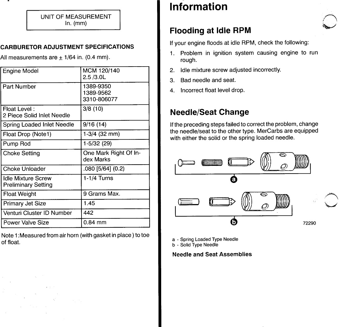

attachment.php
Thanks for the diagram. I found info someplace that the drop needed to be 27mm, so I will readjust that. The needle and seat was replaced less then 12 months ago. I'll make sure there is no crud somehow causing problems.
