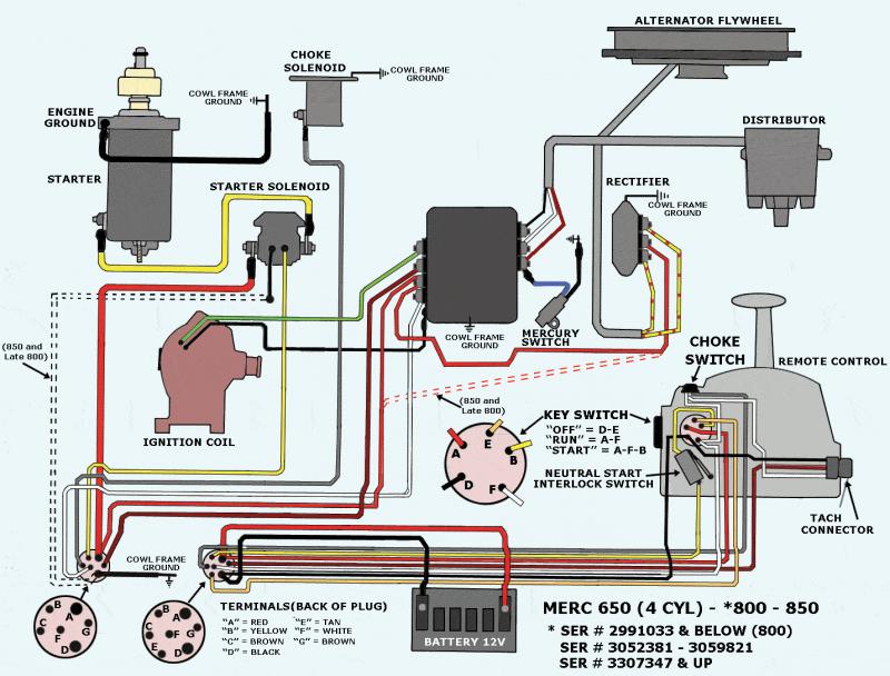

I have a merc 650 and am trying to find out if the connector on the end of the starter harness is replaceable? Did they make just replacment ends or do I need a whole new harness? I am trying to replace the wire as it has about 2 rolls of electrical tape on it and the wire look really brittle. I was lucky and found the image below on the net. That shows the entire wiring for this circuit.

I'm not completely clear as to what you mean by "starter harness".
If all you need is the "ends" connecting to the starter itself drop into any automotive parts place. In fact, you can find a whole new cable there as well (the yellow or black cable in your diagram).
The cables going to/from the starter for this model are long discontinued by Merc, so in any case, you will have to improvise.
If you mean the little pins that go into harness plugs (on the diagram with the A,B,C etc), I have never seen them individually..
