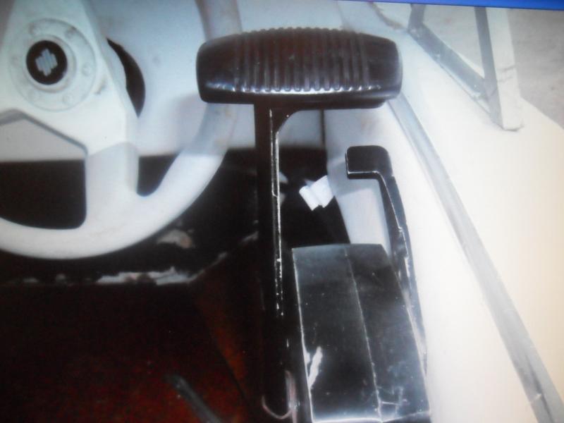

SAM_0744.jpg ok added
The small lever operates the throttle in nuetral, used for starting and warm-up only !!!!.---------The small lever must be returned to the idle position before operating the big lever.--------------------The big lever when pushed forward operates the shift cable first , then gives more throttle as it is pushed forward.-----When pulled back the big lever shift the motor to reverse , then gives more throttle as you pull back further.
When you push forward on the big lever which way does the first cable that moves go ?------------Does it pull forward or does it push back ???-----------------This really should be simple to figure out !---When you operate the small lever only the throttle cable moves.-----Double check / triple check that you have cables hooked up correctly.
Something is wrong,, when that motor shift mechanism moves forward you should be going into forward.----Recheck ALL your work !!-The control box is working the way it should.
Are those your throttle and gear cables running under the wheel?Or are my eyes playing tricks on me?'Cause that control looks like it's sitting back to front.If that's the case,yes, when you push the big lever fwd you will go in rev.
I think you have the throttle and shift cables reversed. (Very easy to do.) Remove them both and watch the action as you go from neutral to full throttle. The shift will move FIRST, followed by the throttle cable. Label each with masking tape, put them on correctly, and go boating!

Need new glasses.The warm up lever all the way fwd looked to me like it was raised from the wrong end.Another Homer moment.Doh. I was going to say "A blonde moment" but I might upset the ladies.:D:D
