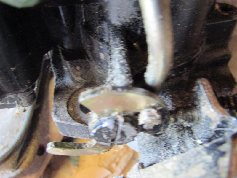

IMG_4570.jpgwhat is this then?

what you show in picture should be a smooth "cam" the main idle screw sits on. It is smooth for a reason and if not it should be smooth.

If that carb has a stepped cam it is wrong.
Someone changed it and should not have.
I have worked on a few thousand carbed boats and I can garentee they all have smooth idle cams. NO STEPS.
