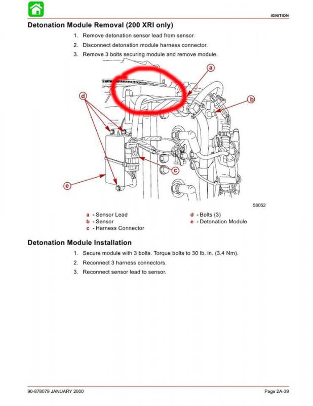

However, even if i did this, the engine still shut down when i opened throttle. I then disconnected the ground of the control box and i was able to plane but i did not apply full throttle as advised by my mechanic. He said if i disconnect this box, i will need to change my timing? What timing should i use without this box and is it advisable to run my engine without this box? What will i be losing out? The box i am referring to is below.
That would be the " idle speed stabilyzer " used to obtain smoother idle.------The dealer would have a service bulletin on what to do when it is removed.
You may just be running lean on the low speed jets.-----Have you tried opening low speed jets ( if equipped ) about 1/8 turn at a time to see if bogging goes away ?
