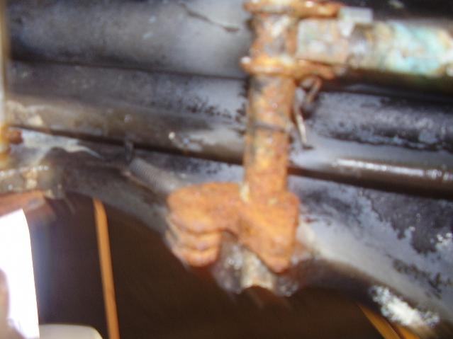

You'll see something like this.Push the hooks up,usually needs to be in FWD,that should let the engine lift.If it doesn't,time to get out the torch and start heating.
PS the reverse lock rod in the pic has been removed,repaired and greased up.:D Yup I got a shock when I saw the state of it :eek:.Salt water.

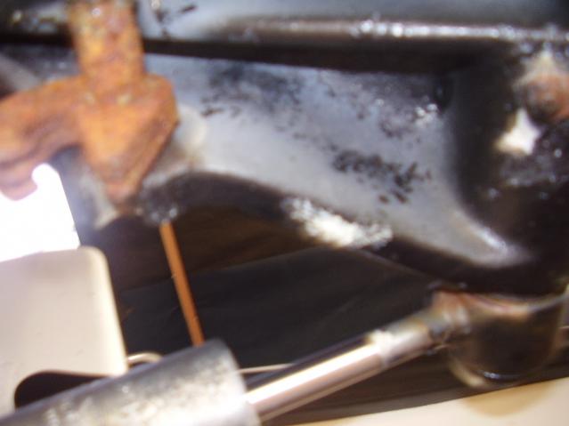

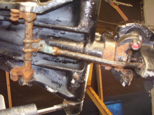

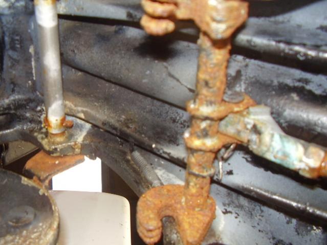

Ok in the first photo on the left middle that appears to be the leaver that I am messing with trying to get the hook mechanics to turn is this correct before I destroy something!
The rod that is attached to the hooks runs into the lower unit and is spring loaded.When put into REV or neutral there is a cam in the lower unit that pushes that rod up and locks the hooks onto a pin.The hooks latch on to the tilt pin.If the hooks are seized,try and knock the tilt pin out. The tilt pin is the pin that runs through the transom brackets.That'll let you lift the engine.
