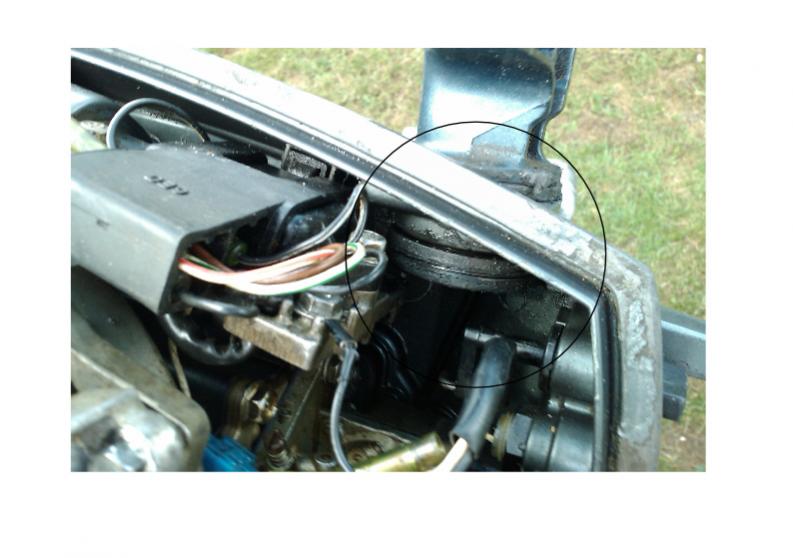

In the video the arm itself is seen rotating about 320 degrees so because the bushes are worn the stops on the outside of the engine ride up and are obsolete untill the whole mechanism is pulled in.
Hope this helps
