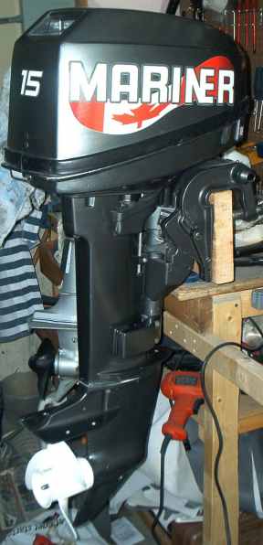

Here is a before and after - you can see the "new" paint is significantly darker. This was about 30 hours of work and 100 bucks worth of paint and custom decals. Not super cheap, but it sure looks pretty :) (and yes, it's the same motor)
