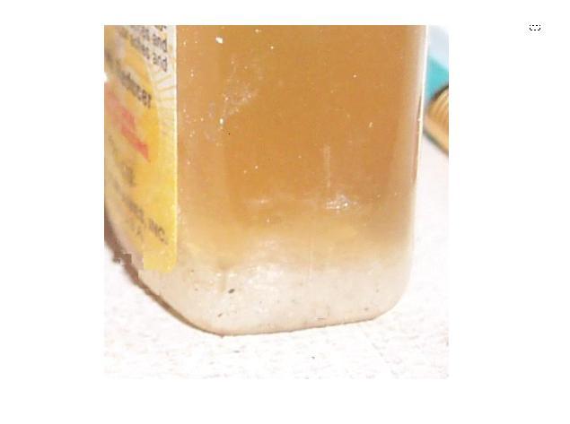

Here's your problem. (See photo.) The fuel tank got moisture in it and--thanks to stupid ethanol--the dreaded white gook (bottom of the jar) has formed. The only thing to do now is pump it out for no known additve will make that white crap burn.
Jeff

Jeff, yea I kinda thought that also but when I did the work I was running the engine on the same fuel tank, 3 days later I had the problem described. Either way, I had to order a new fuel bowl for that bottom carb since it has the leak and the screw seems to not bottom out.
