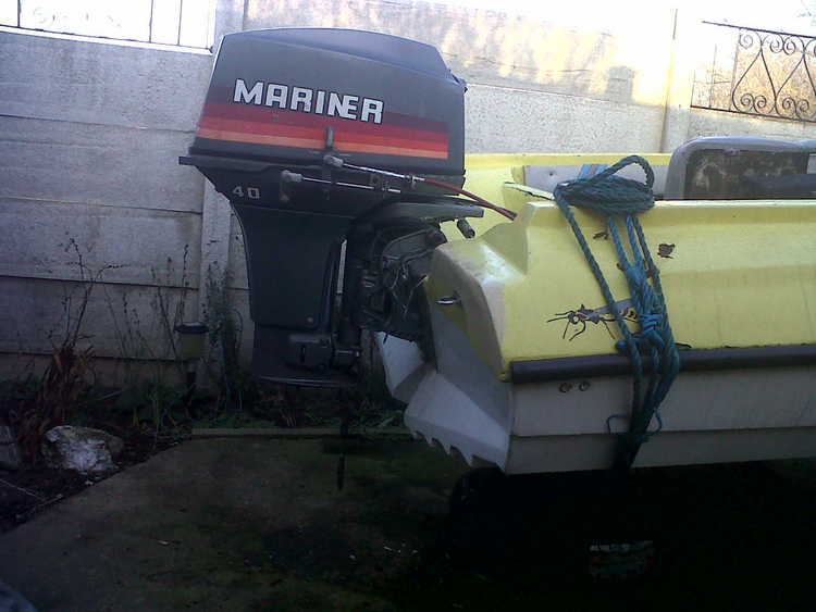

my question is ive recently purchased a speed boat with a mariner 40hp engine but lad i bought it off said it needed prop but bottom end wasnt on putboard ive now tryed refitting the bottom end but therez a long shaft with like 3 groves in it that wont let it full close so i can refit bolts any ideas will be appreciated 4f175d3fa8ad4_1.jpg4f184424cdee4_1.jpg4f184441c2cf9_1.jpg
also the part im on about is attached to outboard in pic also any ideas of year this outboard is thanks craig
Hi Craig,
There is a number on the outboard with a number on it,it'll read 6E9 xxxxxx or 676 xxxxxx. What you have is a Yamaha built mariner.A carbon copy of Yamaha's older outboards,painted in Mariners colours.
The grooved shaft is,I think,the shift shaft and should match with a grooved shaft on the lower unit/gear box,in front of the water pump.That's the white block on the gear box.I can't see it in the pics.There should be a plastic guide in the recess where the shaft comes out the leg.
Put the engine controls in neutral,put the gear box in neutral,prop shaft rotates freely in both directions,push the two together,get someone to turn the flywheel clockwise while jiggling the gear box and it should slide in.If it doesn't work,try both in forward.Prop shaft rotates in one direction and ratchets in the other.

thanks mate will try that and ive got the plastic like a cover thats holded in wi 1 bolt and it clicks in both ways my propeller when i put it in forward gear the shaft slides in perfect but then try put it in reverse or nuetral without bolts in and it lifts it is that normal? if i bolty it down will it not bend the shaft or is it a case of bolt it down n does the shaft just lift n drop for different gears sorry to sound so dumb thanks craig
