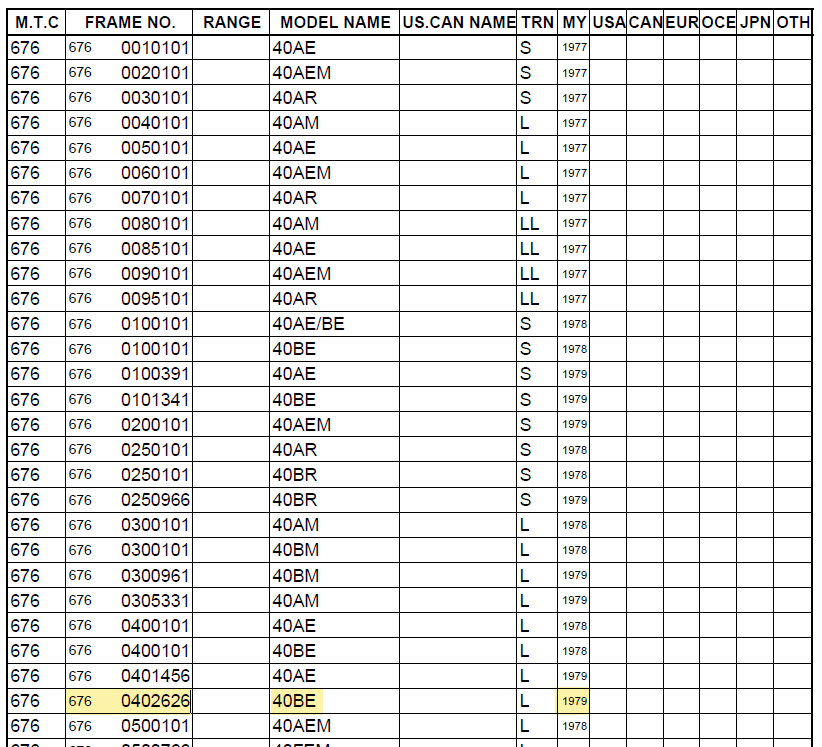

I have what I thought was a 1979 Mariner 40be made by yamaha. When I look up the serial # it says 40EL. Can anyone provide insight? I’m trying to find the weight and parts.
I am in the USA. Yamaha did not start distributing motors here until 1984.
For what it is worth, a 1984 Yamaha 40SN (no electric start) weighs nominally 150 pounds.
Here is a link to where you can find the parts catalog for a 40B model. Find the part number(s) for what you need. Then contact a Yamaha dealer. They may or may not still be available.
