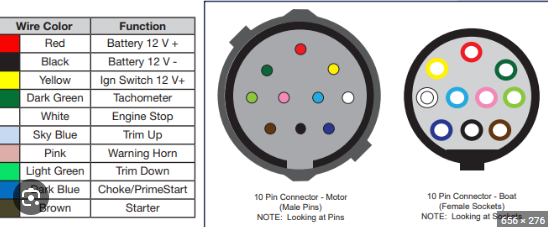

Disconnect the engine harness connector at the motor end. On the motor side side main engine harness connector, jumper the red wire terminal to the brown wire terminal. The motor should crank. The motor may also start. If so, then move on to troubleshooting the harness that runs in the boat.
Check for continuity between the red wire terminal and the brown wire terminal. Key will have to be turned to the start position to do this.
