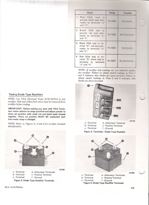

I am having a problem with my 40hp Mariner magnum outboard. I think it is a 1995 model. I took the boat out yesterday and everything ran fine. However when i was doing my fresh water wash, the motor wouldnt start and i noticed i had a flat battery.
I did some research and did the test procedure listed bellow. The rectifier failed this test.
The one fitted is on the bottom right.
I have ordered a new replacement.
However after reading this thread:
http://www.marineengine.com/boat-fo...208-Mariner-charging-query&highlight=charging
I am wondering if the marine battery is something i have to consider. The boat currently has a car battery fitted and looking over the engine and trying to follow the wires i can see no evidence of a regulator.
Should i consider fitting a marine battery before i install the new rectifier? Could the battery be the reason why the rectifier failed? I dont want to install the new rectifier only to break another one.
