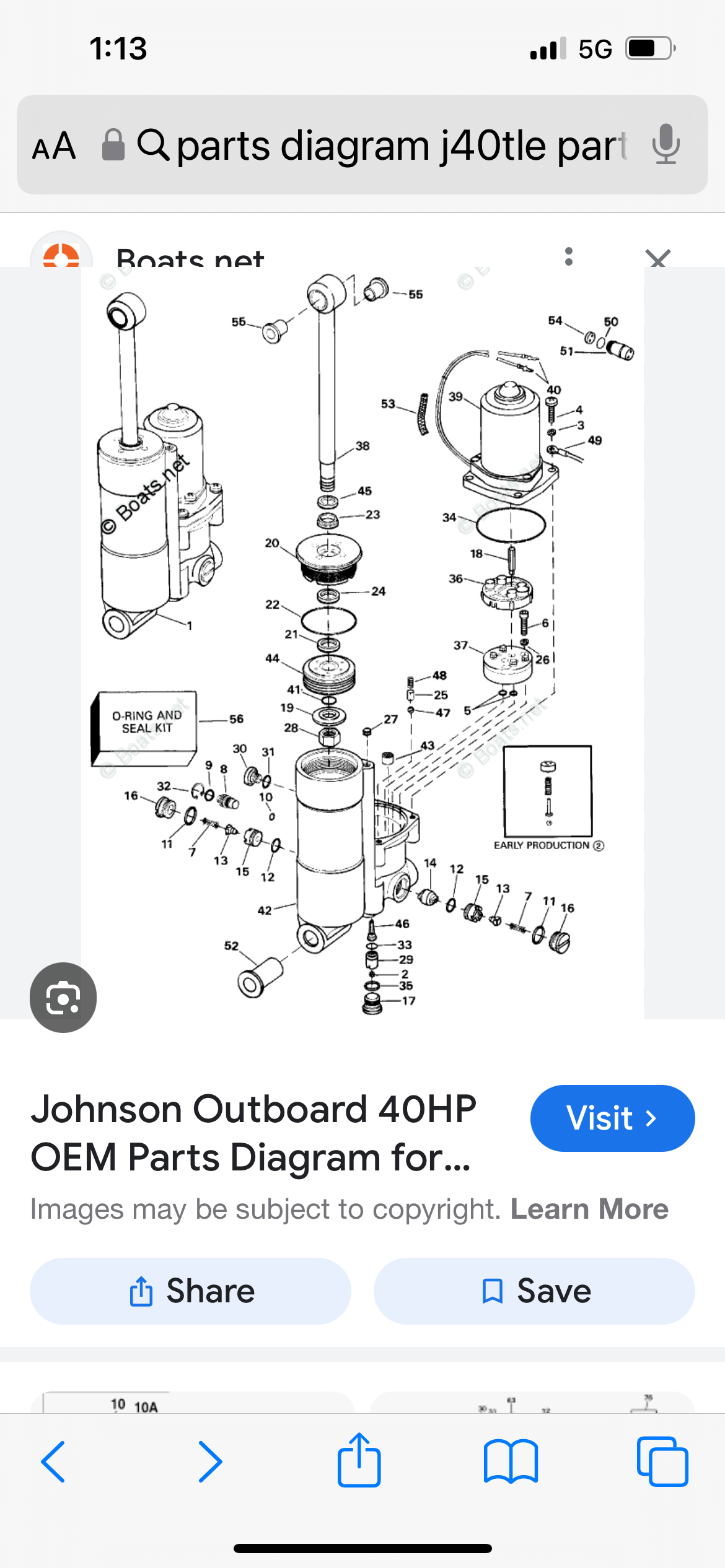

Item #8 on the parts diagram is the manual release.
Apologies : what diagram ? I’m seeing a parts list for the tilt assembly. Is that it?
