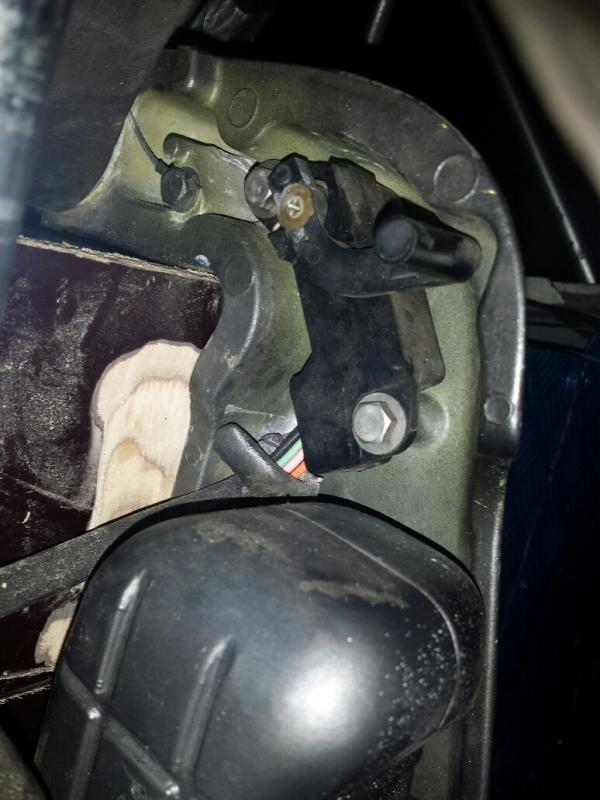

hello frends)),my name is Gediminas,ai from small country lithuania.ai hawe outboard motor tohatsu m60c 2003year,with elecric trim.my boat is old ant it not hawe trim gauge.ai want buy this gauge and swich to my trim.http://www.ebay.com/itm/KUS-Boat-Tr...ash=item1eb8c61b79:g:CDEAAOSwqfNXjjIZ&vxp=mtr how swich to this trim cable to this gauge?thank you.)) 20161206_194344_resized (1).jpg20161206_191300_resized.jpg
You would need either a gauge for a 4-wire sender, or a sender for that chinese gauge. Instead, just look back at the motor for proper trim.
