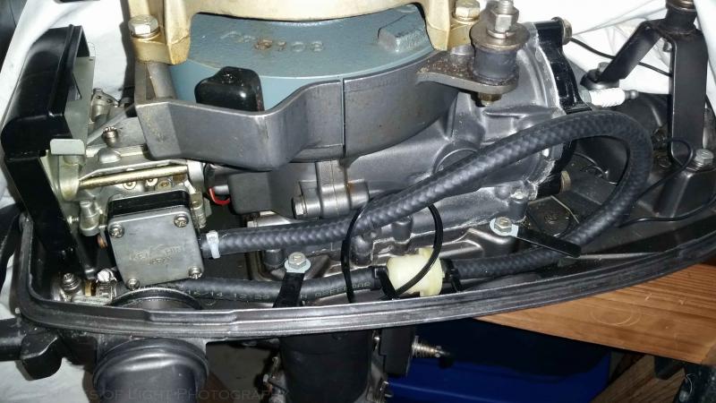

So I am near completion of converting to an external tank . Two areas that need to be addressed:
1) See picture below as to how the fuel line routes from the connector into the carb. I need to make a 180 degree turn in order to flow this into the carb. Not liking have all this hose inside and the resultant loop. Note this is 1/4 ID line. I'm thinking of two approaches to resolve this a) finding a fuel filter- caniser style - one that is used on some OMC or Suzuki engines where the barb location would result in a 180 turn; b) go to the hardware store and find some brass fittings that could make at least a 90 degree bend (ideally with both ends being barbed as opposed to a barbed and NPT at the other end)
2) Need to buy the line from the external tank into the male fitting, is there any advantage of getting 3/8 v 5/16 hose for this line?
