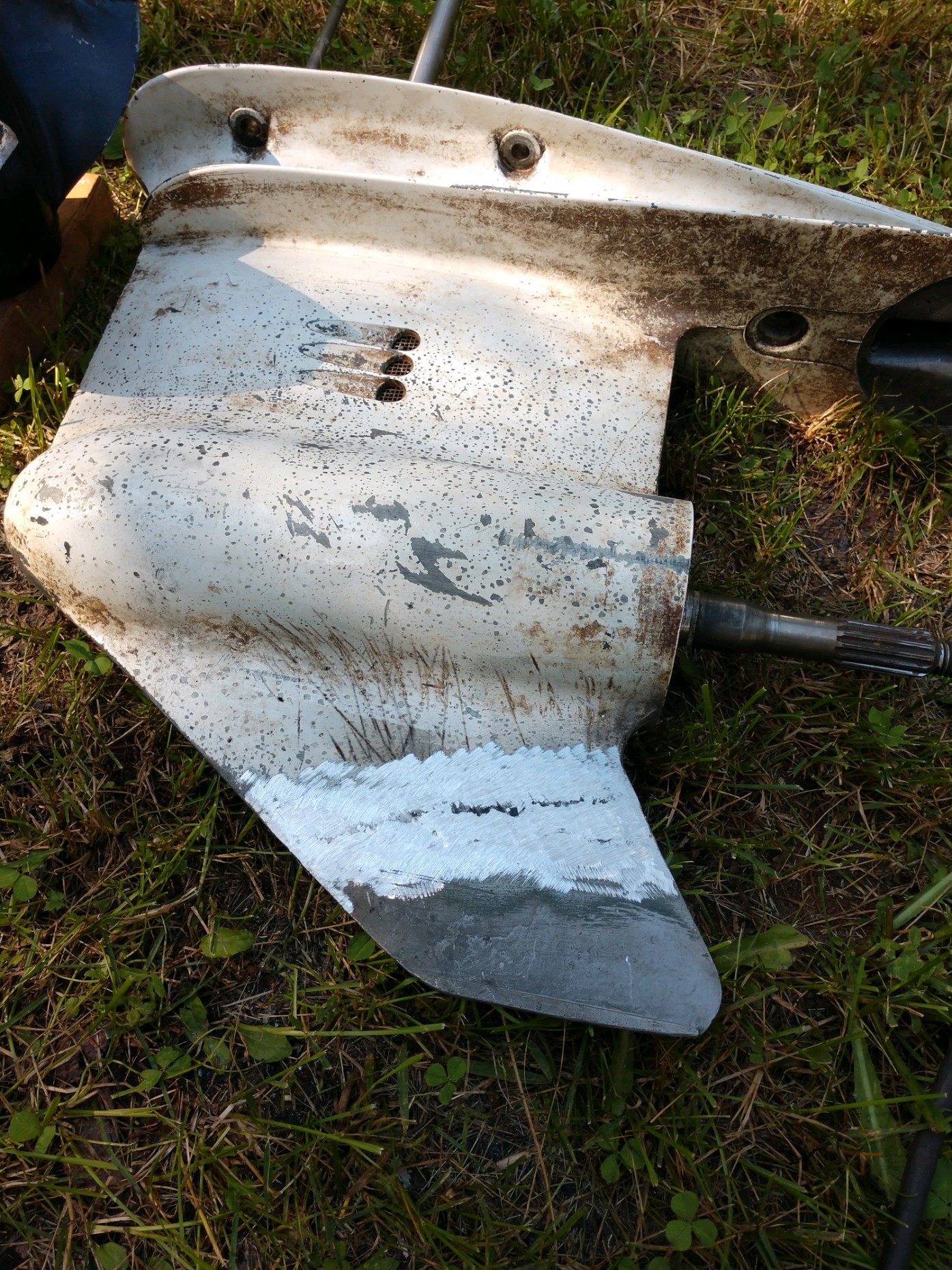

This is a photo of the lower unit in the other post, you may have noticed, before final grinding and paint. I found out later that the guy had somebody running his pontoon boat at the landing and wiped out the prop but the skeg held up, it just was pretty damn sad. Welding is sometimes 60% artwork and 40% skill. While running into a rock is 60% stupidity, and 40% bad luck!
