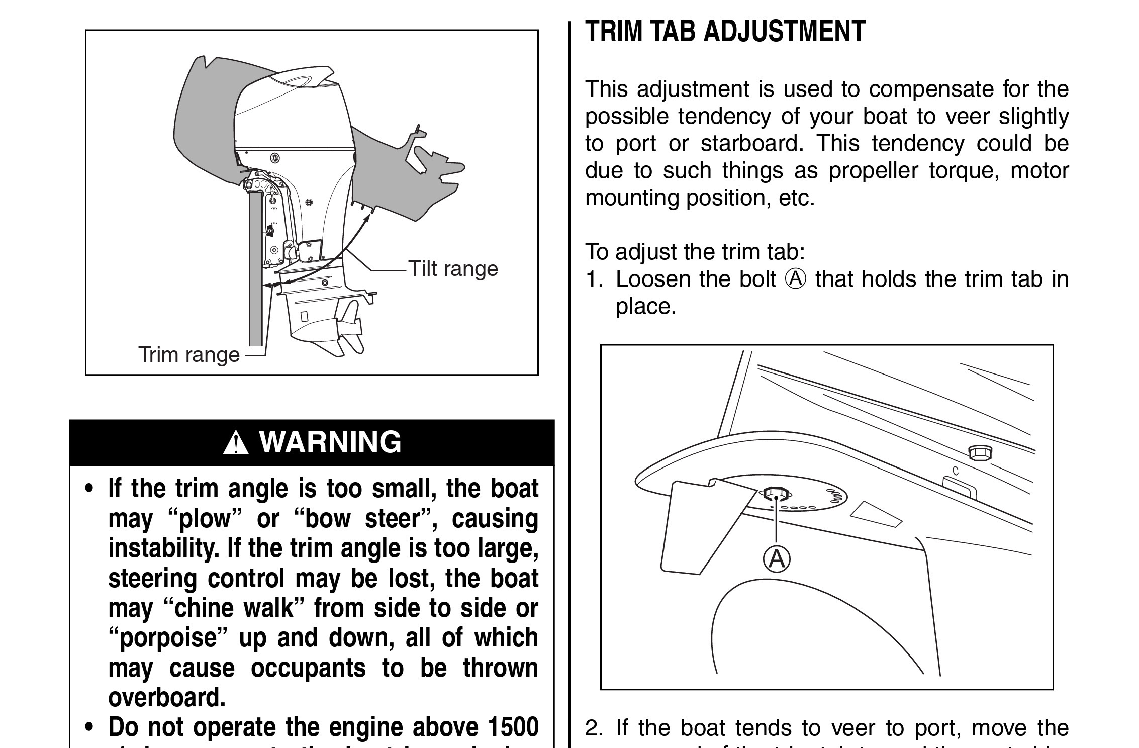

Often there is a bolt hiding under the trim tab. If you have that bolt out and the other visible bolts removed and the lower unit still won’t drop out then I suspect the splines on the drive shaft are rusted on the engine.
Could you send pic of the trim tab you are talking about. Thanks
