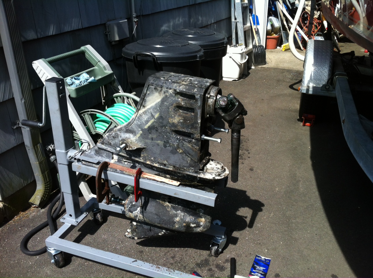

The shift rod has an indentation in it and it fits over the shifter bell crank in the transom mount. They fit together pretty closely and there is no way the lower unit is dropping off the upper if its bolted to the transom mount. The whole works is about 80 lbs I'd say. I've had mine off every year since about 2007 when I started doing all the maintenance on mine. When you pull the drive, the shift rod moves away from the shifter bellcrank and the lower can come off the upper, but the shift rod needs to be turned to the side first to clear the inside of the upper gear housing.
These pix are not great to show it but the first one is the drive on the drive jack if you look closely you can see the indent in the shift rod.
the 2nd pic if you look closely at the transom mount you can see the shifter bellcrank, the shift rod fits over that when the drive is installed. The 3rd pic is the lower unit with the upper removed, you can see the shift rod clearly but its is turned sideways because that's what you have to do to lift the upper off of it. So, no way the lower is dropping down when bolted to the transom mount. Not like an Alpha. This is a salt water boat in case you're wondering why it looks that bad. Still works great though.
