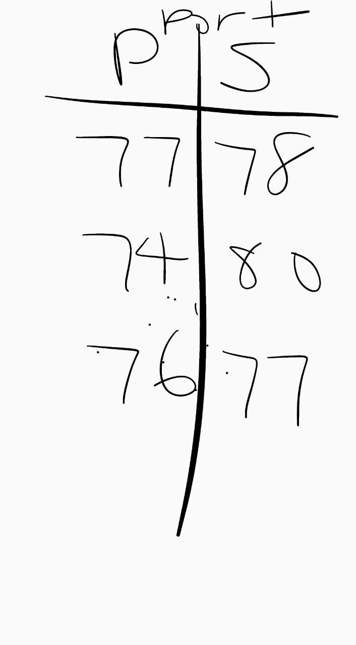

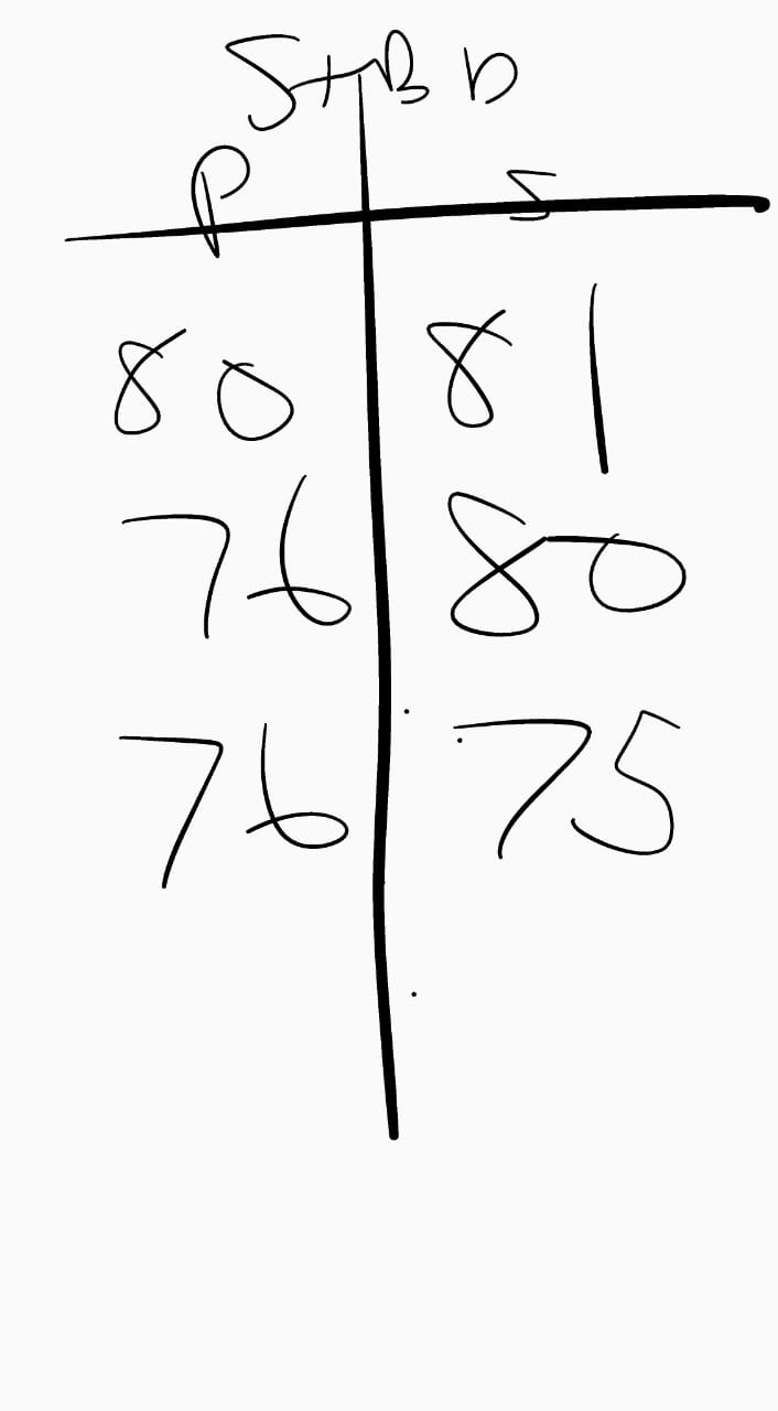

I had a compression test done, and all the numbers came back low. Lowest at 74psi highest 81psi across both engines. Now I could understand if one or two cylinders are low and the rest are high but what will cause all the cylinders on two different engines to have such low compression?
I am looking to see what you experts have to say on this. Any help will be much appreciated.
