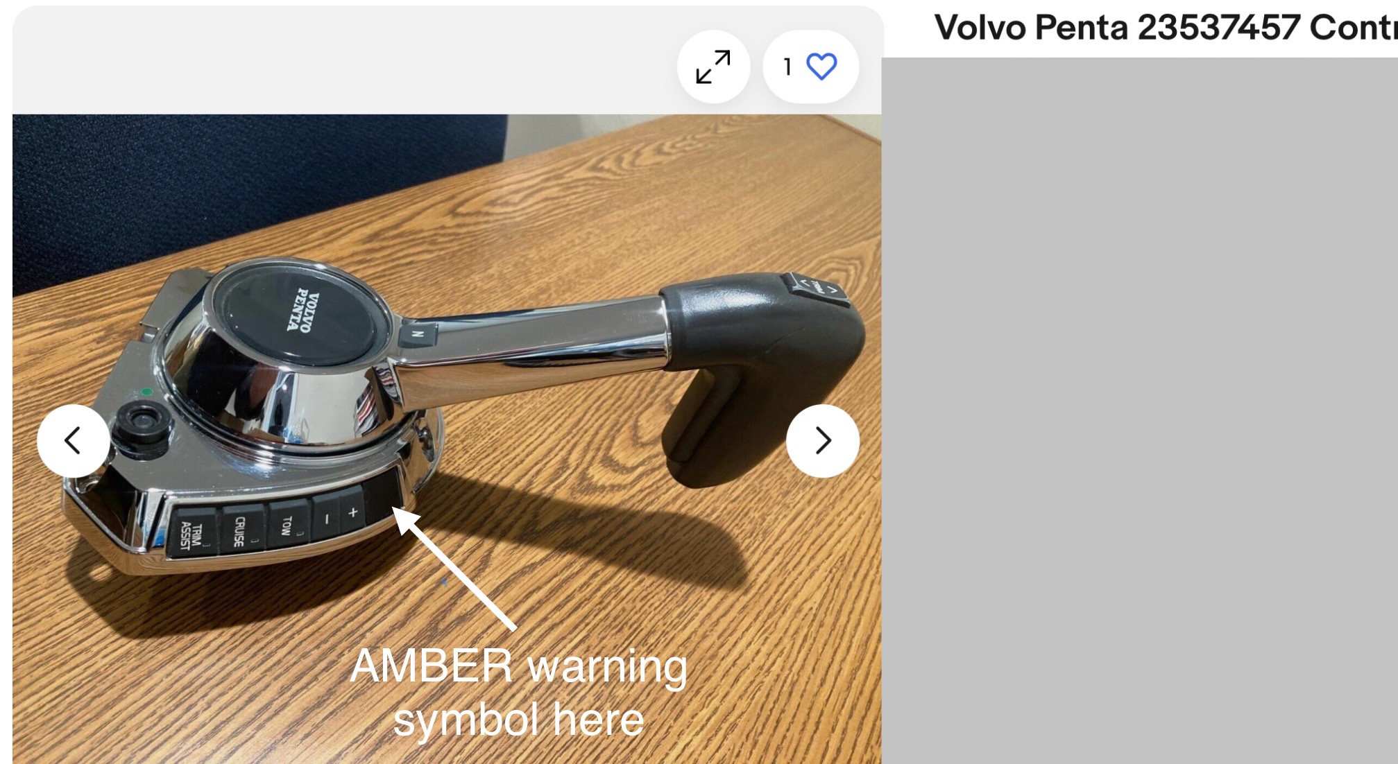

- Throttle and stern drive are controlled by a side mounted control lever (part #23537457) equipped with a small diagnostic LED display as well as trim, neutral, + -, tow, cruise & assist buttons.
- This is a totally electronic (fly by wire) control lever - no mechanical linkages to the engine bay.

- All dash gauges showed normal temperature, oil pressure, etc readings. Turned the engine off, waited a bit and restarted the it - no change. The lever control’s trouble display showed an AMBER warning light but NOTHING on the dash EVC display.
- Pushing the throttle lever fully forward or in reverse never changed the RPMs - just sat idling. It was as if the boat thought the control level was in the neutral position. Boat had to be towed and of course worked just fine a day later.
