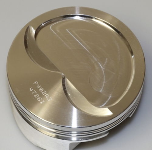

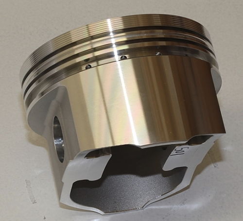

what piston profile are people using with the 64cc vortec heads to get the proper Quench effect? i have purchased my felpro marine head gasket set but can't seem to find the compressed thickness dimensions.
is it better to piece together the necessary parts in order to get the proper pistons or does someone offer the correct kit?
