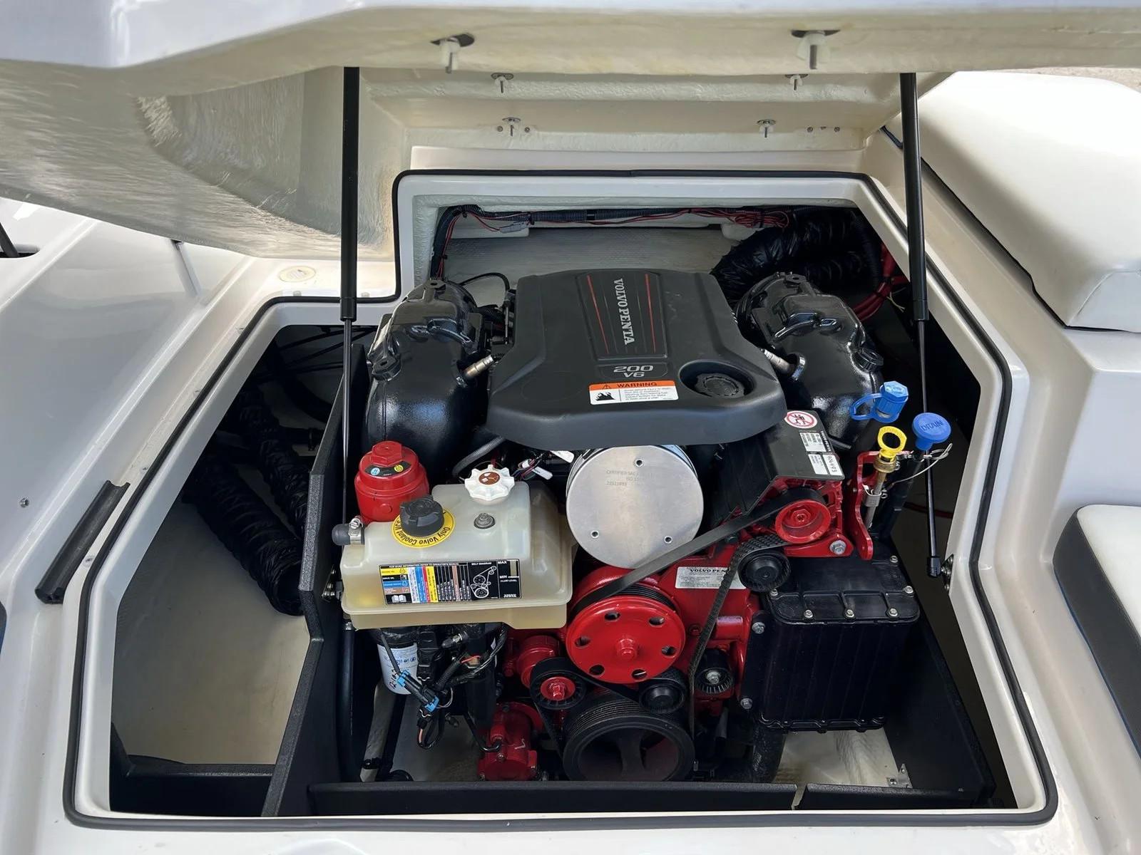

Depends on the engine compartment, seating and how far back it is from the back of the seats. Hopefully, they designed the boat so removing the engine isn't impossible.
If it looks like the photo below, I don't think it will be too bad- the engine cover-rear seat will need to be removed, as well as the dark side panels next to the exhaust manifolds.
Take a lot of closeups of every operation, bag parts and label the bags clearly. The engine will have a plug at the rear for the main harness and the mounts for the engine can be left on the stringers- remove the locking nuts & stainless keepers and DO NOT mix anything from one side to the other.

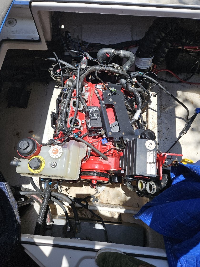

PS: the engine pic you posted is exactly like my engine. I think the entire engine harness has maybe 2 or 3 points of contact in the back, disconnecting those will free up the wiring harness and the wiring can stay with the engine.
I also found 2 hydraulic lines that connect to the steering system, those need to be disconnected as well. Only other thing is battery cable and ground wire....need to see where is the best place to disconnect the red positive cable at the starter or the battery.
Here's a pic of my partially disassembled engine.
The alignment will have more play if the whole mount comes out- if the nut is removed, the play is limited by the hole size be stud.
An alignment tool is available but you may be able to rent one. A yoke from a sterndrive would work too, as long as it's known to be straight.
