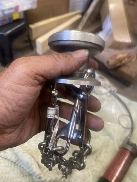

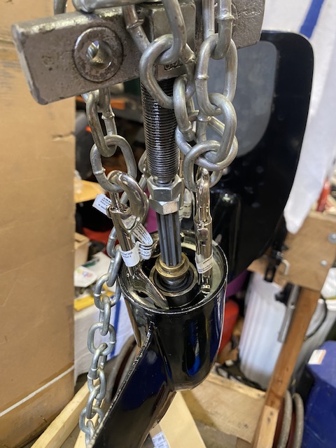

First of all would like to say, thank you for that link on the Tool! It worked like a champ.

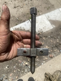

Now I’m wondering is there any way of pulling the bearing carrier without the proper tool.
It almost looks like it’s threaded, but I told it’s not anyone know for sure?
Model 200
20 Hp
Serial 2552657

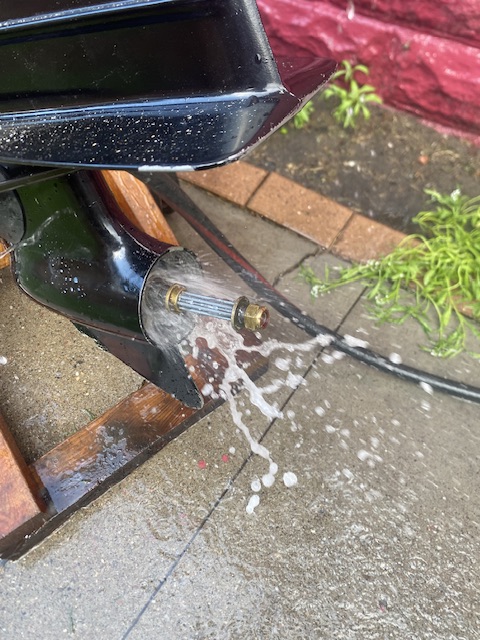

1) anyone have any idea?
2)Is water supposed to come out of there?
3) what would I need to replace or repair now?

Thr oil was where I added some where I probably shouldn’t have.
In the vent. Grr :-(
Think I was able to get most of it out. And the water is normal coming out of the lower exhaust area . Had the muffs hooked up while running.Pee hole can only push out so much water and the excess comes out there. That’s what I was told.Oil in the lower unit was milky so I ran and drained it 2 times. One last fill. Now going to try and take it out this weekend and see how she does. Then change it one more time. Sitting 30ish years the oil got pretty thick.
