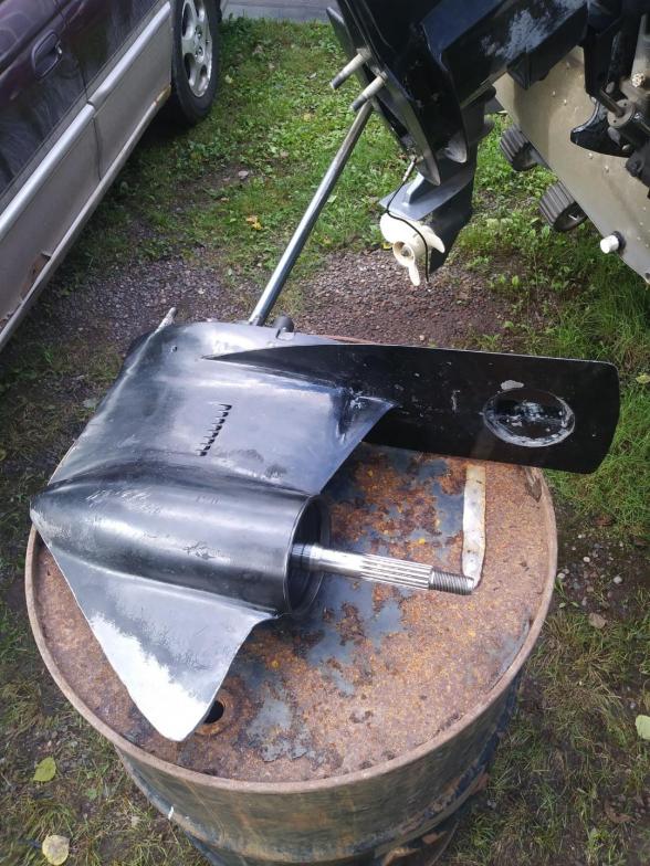

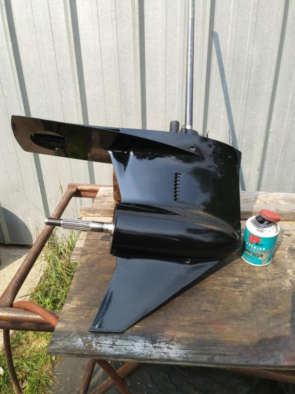

Optimax 5.jpgOptimax 6.jpgHere is a recent skeg and prop shaft repair, replaced with another skeg cut off a similar Merc. Paint is automotive base/clear. Before and after.
