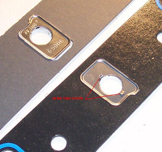

In a weak moment, I allowed the marina to work on one of my 360s. The "mechanics" omitted the metal plates that MUST be included in the intake gaskets, which promptly leaked (of course). After they re-did their work, the gasket never leaked again.
The photo shows what the gaskets SHOULD look like at installation. It's possible the plates on yours were left out--like mine--or rotted out over time.
Jeff

"suspect it might be from leaking valve cover"
Fix the inexpensive valve cover gasket if its leaking. Dry up the oil and see if the hole fills up again.
yeah, going to try that 1st. seemed odd the other engine had a gasket over the holes. only one side of this engine was wet, the other was dry. will see how it works out thanks for the replies
