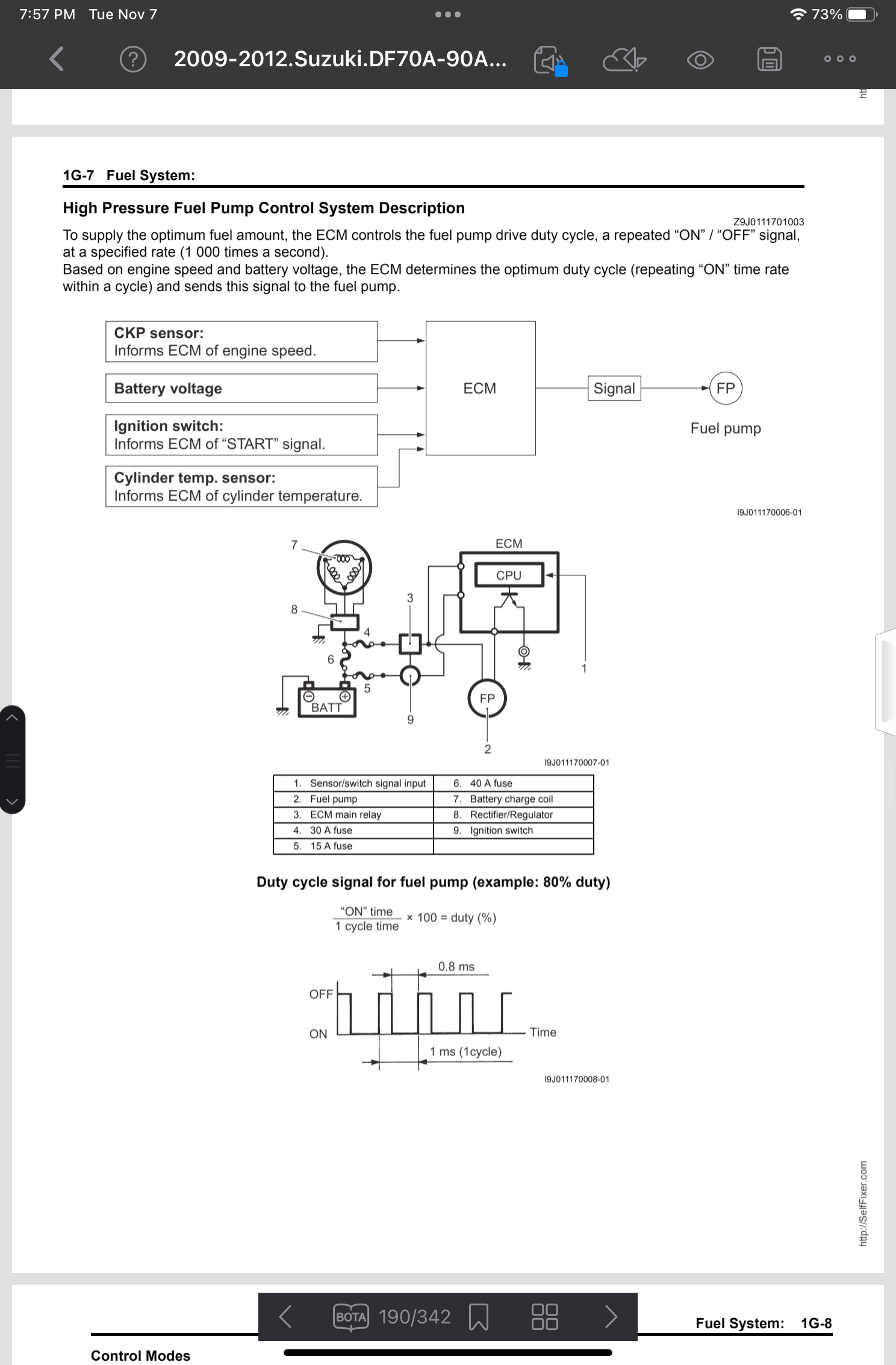

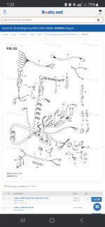

Boat sat for 4 yrs. 2006 70 hp 4 stroke susuki, electric pump is junk , ran wires from battery right to it and nothing. No ohm readings either. But it must have had bkown the fuse. I only located 1 fuse so far. Anyone know where the other one is , i looked at manual ,it shows 2 fuses. I found the one in the upper right of picture. Any help is appreciated. Thanks
