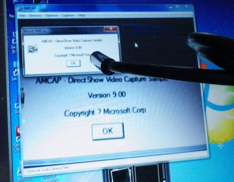

If your going fishing a set of eyes might help. Works pretty good and at low cost. Just a little wait on the shipping. Lol, Another toy for the toolbox.
http://www.gearbest.com/microscopes...ebook&utm_medium=WebsiteC&utm_campaign=FB1511
Some images from these posted here .............
http://www.forbbodiesonly.com/moparforum/threads/mini-endoscope-for-smart-phones.109050/page-3
