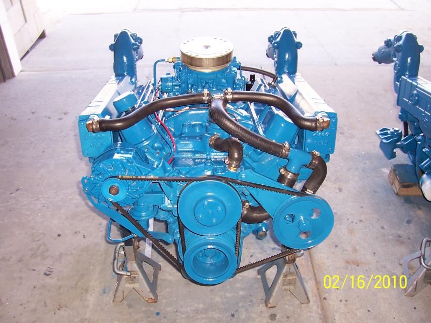

I have restored a pair of 1978 (Raw Water Cooled) LM318's and would like to know if any members with similar engines could post a picture(s) of the front of their engine. I would like to confirm the raw water plumbing that I have installed is correct. There is limited information/pictures on this subject. Thanks for your help!

Jeff H - based on (Fast) Jeff's pics, it looks like your routing/fabrication is accurate.
Did you reuse t-stats or are they new?
