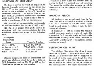

I recently changed the oil and oil filter in my Chrysler LM 318. I now have a higher oil pressure, its moved from the Operating Manual specified pressure of 65 psi to around 85 psi. I'm not sure if I should be worried by this and don't know why it would have changed.
The new filter is the same brand and type as the one I replaced and while the oil is not the same brand used before the oil is the correct specification SAE 30, 20W-50.
Any advice you can give would be appreciated.
