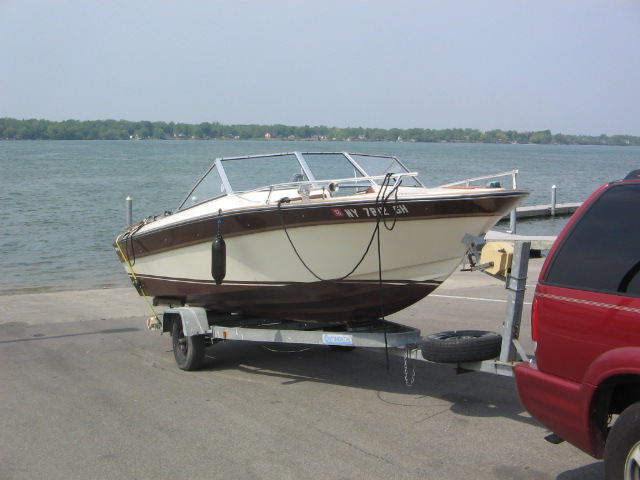

Launched it today and everything was great. I could only get 3000 rpm w.o.t. out of it. Motor was smooth, good oil pressure, good temp , everything fine except the rpm"s. My marina says it should be able to get to 4000-4500 rpm, with the 2.5,120 hp,OMC and it could have the wrong prop on it, which would cause the lower rpm. I need an explanation. Thanks. Here's some pics also IMG_0003.JPGIMG_0007.JPGIMG_0009.jpgIMG_0014_2.jpgIMG_0018.JPGIMG_0032.jpg

it's more likely a lack of power (gummed up advance weights in the distributor a probable culprit), but what pitch prop is on it? should be a 17P I'm thinking, maybe a 15P if that's a bigger boat than it looks - looks 17.5 foot or so

It's an 18.5 footer. We're gonna pull the prop tonight to see what exactly is on there. I have an extra prop that came with the boat and I'm thinking that is the right prop that he may have damaged and had fixed, and used the one on there now as a fast replacement which may be wrong, just to get him going again. Is there a set rule for the boat or the motor and outdrive as to what the correct prop is for the boat? that is size/pitch whatever else.
