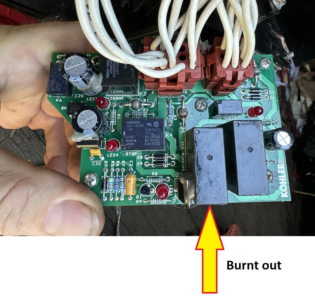

Need cheap PCB (GM10516D061605 Controller).
Anybody have one?
