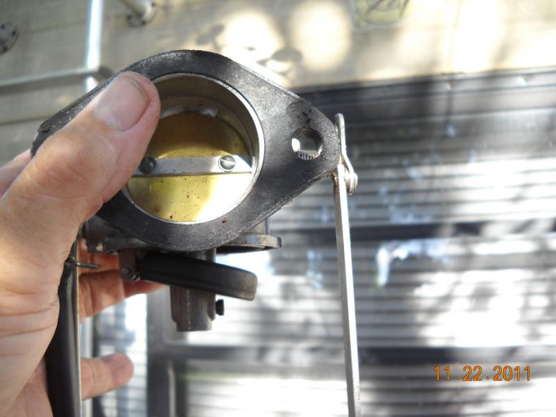

Recently worked on a 125 Force.The guy spent $500 to have it FIXED at a local Ft.Lauderdale marina.
They were supposed to change hoses and rebuild the carbs and do something minor like setting the timing..
They managed to change the hoses,no problem.

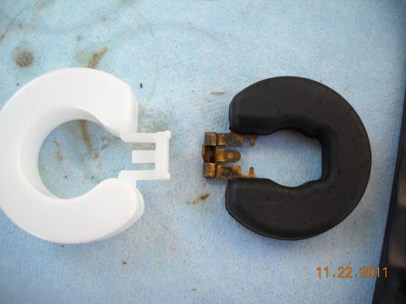

The carbs were set wrong and the parts put in were junk.(see pics)
The floats were not adjustable,never heard of that in a Force.
The carbs wouldn't stop leaking no matter what I did to them.
The one pic (white)is the junk float.The others are the correct float levels.
Float level pic is supposed to be flat.
The float drop is not supposed to touch.J
