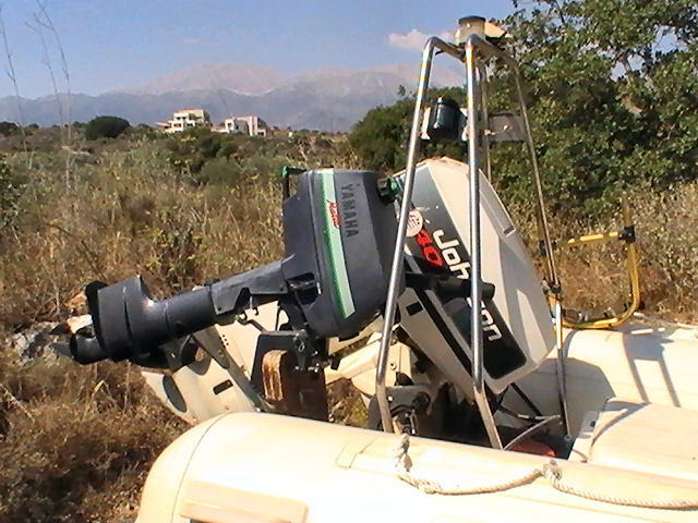

I have a Jonhson 40hp 1996 vro engine

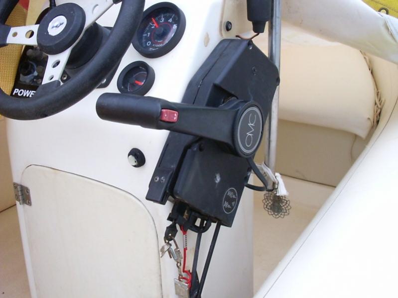

My engine on the console in the rpm instrument, it has four leds to check the engine like no oil, low oil ,hot, etc, all the leds are off , when I switch the engine on, the buzzer, and the alarm leds make the usually routine, all on and then one by one goes off.

I remind you the alarm leds are always of ( no alarm )
