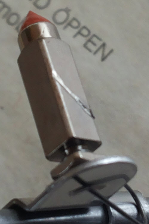

- A small deep scratch on one of the floater pins where also detected, looks man-made by previous owner perhaps, but I can´t feel that the scratch effects the function of the floater. See Pic.
