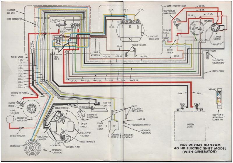

Hey Everyone,
I just inherited an old 1963 johnson super seahorse deluxe that was sitting for 20 years. I took apart and rebuilt the motor and everything looks great but now I'm onto the task of rewiring the electric start junction box. None of the wires were connected to where they were suppose to be and the board that holds fuses is cracked and missing some of the fuse holders. I am thinking of just using some inline automotive fuses instead of trying to rebuild the fuse board. I bought a new solenoid and the voltage regulator, at least that's what i think it is, looks pretty good on the inside. Does anyone have a picture of theirs or a diagram to reference? What size fuses would it use?
Thank!
