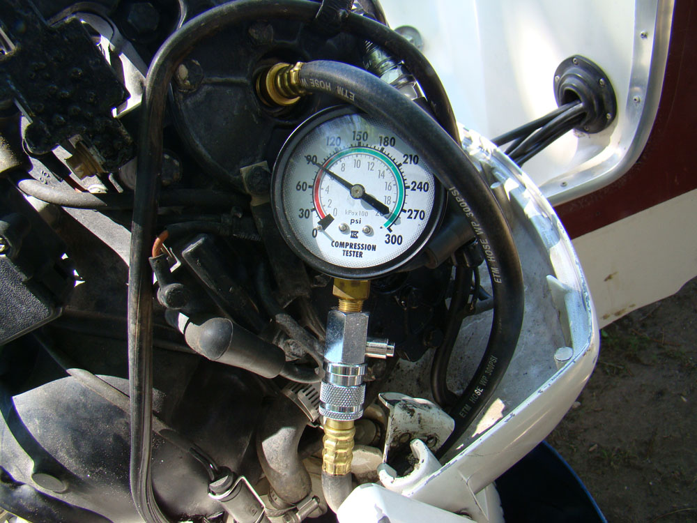

Here is my findings.
Cylinder # 1 = 90 psi
Cylinder # 2 = 90 psi
Cylinder # 3 = 90 psi
Cylinder # 4 = 90 psi
There is absolutely no difference in the readings, not even a fraction.
And this was with all plugs removed, and using a brand new compression gauge with screw in fitting, and cranking the motor over many revolutions and the same for every cylinder.
I also checked the spark on all 4 plugs and it is strong, blue, and hot Comp.jpg
Throttle should be wide open when checking compression. Numbers should be around 125psi, but they are even so maybe high hour engine? Did you release the gauge back to zero before checking the next cylinder. Seems odd they are all the same. As a caveat many engines run good with compression that low.
