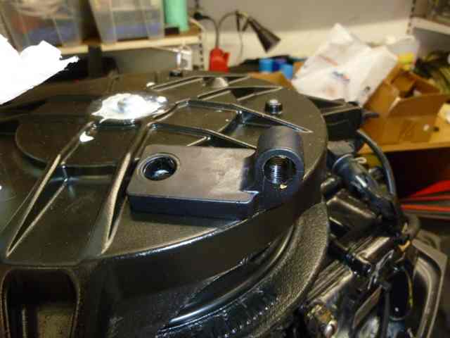

I actually try to rebuild my engine from remote-control steering/shifting/accelerating to normal steering shift handle.
Mounting the steering shift and shifting R/N/F works. The problem i have is, how the throttle cable is connected inside of the engine. I add a picture of a part, i do not know where to fix it. Eventually somebody could send me a picture from inside a similar engine, where i can see how the cable fits inside the engine housing.
Thank you very very much,
greetings from Austria !
Oliver.
