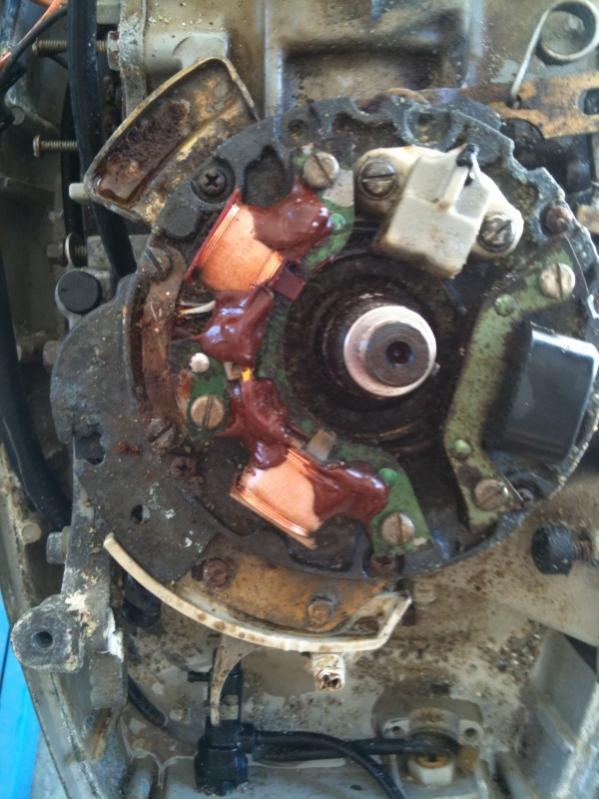

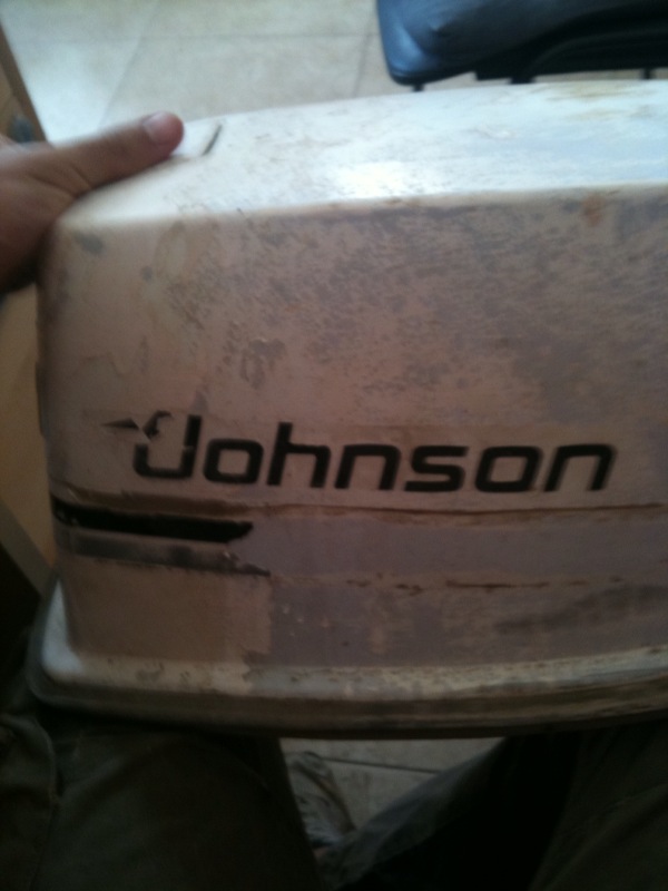

Hello. My grandfather gave me his old Jonson to restore it and use it in my boat. Unfortunatly he does not remember anythin about the model etc. THe engine was outside for over 10 years:( i buy the manual from seloc but i think i make mistake about the model. I put the 1995 johson 2 stroke jet!! :mad:. I am idiot. please can you give me some info about my engine because i want to restore it...thank you for your time

It looks mid to late eighties.
Tiller handle and shift lever alone put it 1985 to 1989 . At least as far as I can tell from your photos
There should be an plate on the transom clamp bracket with model and serial numbers on. The model number will tell all.
If that plate is missing then look for a round core plug on the engine itself. You may find the model number there.

thank you!
model No: j35BALCRR
SERIAL nO :b015508
were can i check the model specificstions, parts etc? do you know how can i change the model in seloc manual??
J= Johnson
35= 35 hp
BA= AC lighting coil and ropestart
L= Longshaft (20")
CR = 1984
R= just a suffix .. no meaning
Belgium made ??
Fuel mix 50:1
Plugs (latest recommendation) Champion QL77JC4, gapped 0.030"
Not been used in a while therefore read Awakening a sleeping outboard
Parts and exploded diagrams to be found in the electronic parts catalog at http://shop2.evinrude.com/Index.aspx?siteid=1&catalog_id=0&s1=c23601c9cfd92dff1c8569439a63226c Except that you wont find that exact model listed.. quite common if its is a Belgium made one for the European market
Sorry dont know what you mean about the Seloc manual.
OEM manuals always miles better anyway. http://www.outboardbooks.com/

thank you very very much. yes is belgium made. i am going to read the article and you will have news from me soon
:(:(i think my engine is officially dead. it does not worth to fix it....does it?
